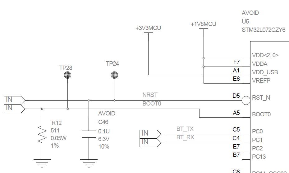

I am attaching a portion of my circuit for reference. With this configuration I always see NRST is held low. I tuned the +1V8MCU power supply to 2.2V and still NRST was low. I connected +3V3MCU rail to VDD, VDDA and VREFP and surprisingly NRST got pulled high (3.3V). I got excited and tried programming the board but still the result was same. I put back the VDD, VDDA and VREFP to 1.8V and NRST was back to low state. I can see the controller is doing something internally but not able to figure out what!
I checked C46 and the value was 106nF, so I guess thats good. I tried removing C46 altogether and it didnt do anything.
Hi @Peter BENSCH, please help if you can figure out whats going on. Thanks

>>Is there any tool (SW/HW) using which I can communicate with the device via UART by pulling BOOT0 high?
For quick testing I'd use RealTerm in hex mode.
The core would need to be running, which won't be occurring if NRST is clamped low.
The protocol is described in AN3155, as I recall. Want to connect at 9600 8E1 (Even Parity), sending an 0x7F pattern, looking for an 0x79 response.
