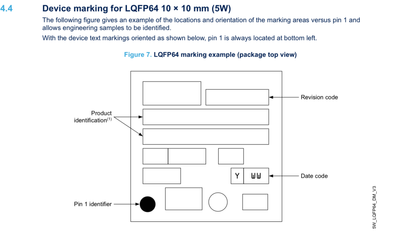

according to the DS8626, the MCU you are asking about is a LQFP64 (10 x 10mm). So, referring to the TN1433, the marking on the package top view is exactly as follow:
So, check if your MCU follow this model. If it is not, please send me a privet message on the ST Community that include a picture of your MCU.

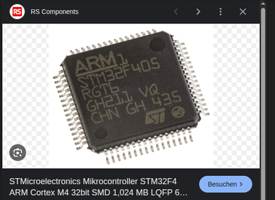

If you just see two "marks" , dont worry about, only one is pin1 marking; more might come from the package.
see image from rs :
This is as it should look.
