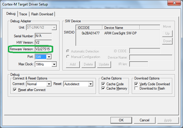

How do I find the firmware version?
Well there is the debugger configuration pane in Keil, or you could use the ST-LINK Utilities.2016-06-23 6:34 PM

The firmware version is something else, and can be updated to the current release via the ST-LINK Utilities.

OK. I just upgraded to V2.J27.M15 via ST-LinkUpgrade.exe
