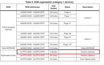

0x1FF0xxx is in the system memory range:
Check if you pulled the boot pin to VDD.

It was really the boot pin. I connected to GND and it solved the problem.
Thanks a lot!!
