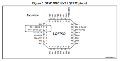

STM32C051K8T
2025-03-18 9:33 AM

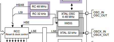

Ah yes - that one has the shared OSCx pins:
OK as long as @MSipo doesn't also want the LSE ...
