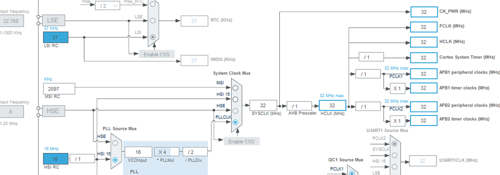

I'm working on a custom board with an stm32L051 and the HSI16 crystal. I'm setting the clock registers, Flash, PWR and then I try to enable the clock for TIM21. as you can see in the code I set the bit but the computer "doesn't listen"(I am looking in the APB2ENR reg in the debugging env). anyone had this issue?
adding the clock diagram and code.

2022-06-07 5:48 AM
Where is the program counter? Does it reach instructions which set APB2ENR at all?

2022-06-07 9:43 AM
I mean, check, if your program gets through the clock setup. For example, place a breakpoint at the line where APB2ENR is written, does the program get there?
Generally, single-step the program and observe registers which are written.
Also note, that PWR_CR.is nonzero after reset. Reading it out and checking against RM would indicate the potential problem.

2022-06-08 4:37 AM
Hi, I have tested it in a step by step way and sometimes it reaches the line and sets the reg, sometimes it reaches and doesn't set and sometimes it glitches to 0xFFFFFFFE. also PWR_CR is nonzero, the VOS bits are set by default,
