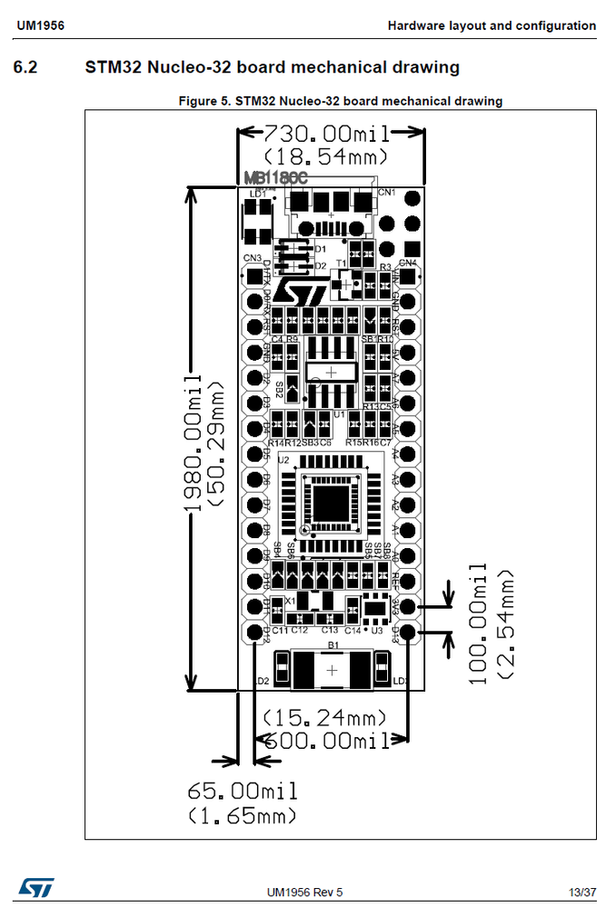

Probably not:
https://community.st.com/s/question/0D53W000000Zoij/is-there-a-3d-model-of-the-nucleol432kc
But you don't need a 3d model to determine the footprint. The relevant dimensions are in the user manual.
