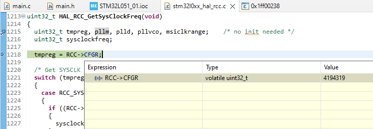

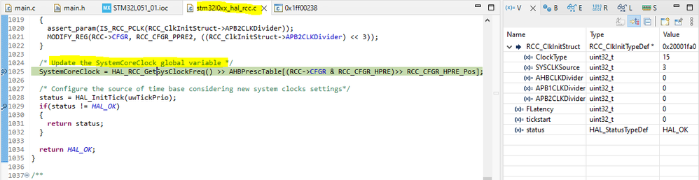

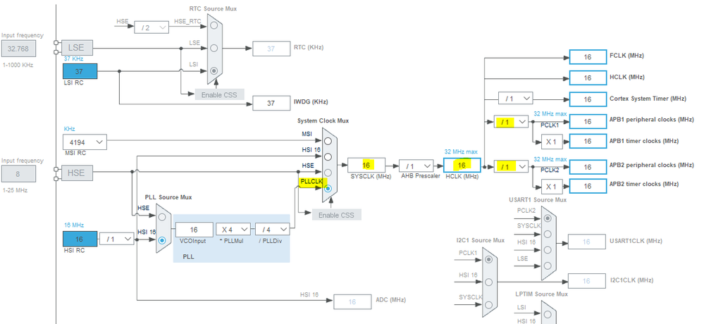

Hi folks,
Any help is GREATLY appreciated!
I set the MCU to 16 MHz using a PLL
where halt at the CPU initialization.
System Clock Configuration
System Clock source = PLLCLK
HSI (mHz) = 16
PLL Source = HSI
PLL Mult = 4
PLL Div = 4
SYSCLK(mHz) = 16
HCLK(mHz) = 16
AHB Prescaler = 1
APB1 Prescaler = 1
APB2 Prescaler = 1
VDD(V) = 3.3
void SystemClock_Config(void)
__HAL_PWR_VOLTAGESCALING_CONFIG(PWR_REGULATOR_VOLTAGE_SCALE1);
RCC_OscInitStruct.OscillatorType = RCC_OSCILLATORTYPE_HSI|RCC_OSCILLATORTYPE_LSI;
RCC_OscInitStruct.HSIState = RCC_HSI_ON;
RCC_OscInitStruct.LSIState = RCC_LSI_ON;
RCC_OscInitStruct.PLL.PLLSource = RCC_PLLSOURCE_HSI;
RCC_OscInitStruct.PLL.PLLMUL = RCC_PLLMUL_3;
RCC_OscInitStruct.PLL.PLLDIV = RCC_PLLDIV_2;
Error_Handler();
RCC_ClkInitStruct.APB2CLKDivider = RCC_HCLK_DIV1;
if (HAL_RCC_ClockConfig(&RCC_ClkInitStruct, FLASH_LATENCY_0) != HAL_OK)
Error_Handler();

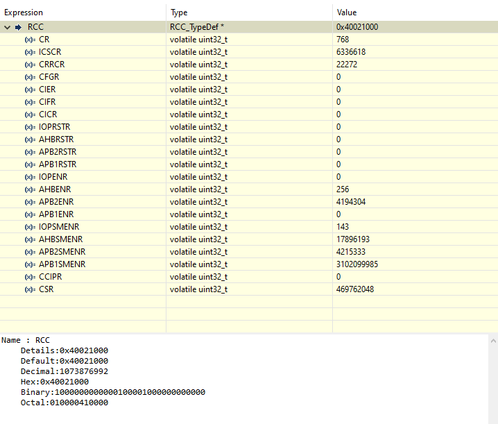

}I decided to dig deeper and figure out exactly where it freezes
then -> could not pass RCC->CFGR
Current values:
The complete project is attached as well.
Please help!
Thank you,
Dave

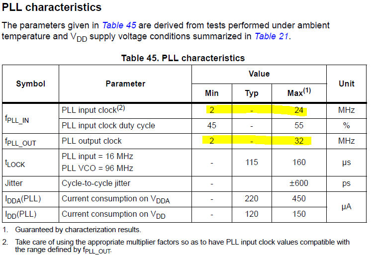

2022-12-15 10:38 AM
How is your version STM32Cube_FW_L0_V1.12.1 or ?
For PLL stability you need stable Vdd and primary Vdda
2022-12-16 12:41 AM
I also thought it might be from the board and replaced the MCU on one of my NUCLEO-L053 with L051 and the result was the same.
Yes, I'm using FW 1.12.1 but unfortunately, there are no examples and templates for L051
