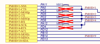

2025-07-17 9:42 AM - edited 2025-07-17 9:44 AM
In the schematics cutout, the red crosses are unpopulated solder bridges.
Like the one that could connect pin PD5 to PMOD#2. The numbers are hard to guess, indeed.

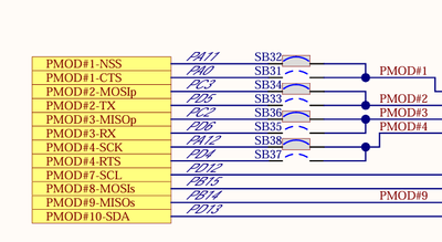

Found a better one for rev. D04 here: https://www.st.com/resource/en/schematic_pack/mb1248-h747i-d04-schematic.pdf
so you have to open SB34 and to close SB33 for that.
Similar, open S36 and close SB35 for PD6 connection to PMOD#3.
Unfortunately, they are not mentioned in the UM2411 user manual, couldn't locate them on the board.
Double check with the board docs before turinng the soldering iron on.
hth

Im suspecting my issue is on the hardware side. Do I have to close/open any solder bridges on the STM32H747I-DISCO to enable UART communication over the STMod connector? Im pretty sure my configuration in CubeMX is correct.
Yes, when using PD5 PD6 ,see the data sheet
I would suggest using UART8 with pins on the Arduino connector:

Wow thank you! I completely missed that, I guess the reference manual of the board was the wrong place to look at. Ill modify the bridges and then try it again. My code is currently running on the M7 core. Is there any major difference when running on the M4 core?
