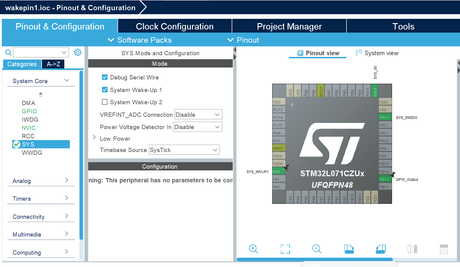

I would like to use system wake-up pin 1 (PA0) as an external interrupt to wake up my MCU from standby mode. Understand that a rising edge on PA0 (wake-up pin 1) should trigger the MCU to exit standby mode. However, I am encountering difficulties in waking up the MCU using this pin. The pin configuration is shown in the attached picture.
Circuit: Supply high voltage to VIN (5V)to wakeup MCU.

Vin is 5v, after volatage divider will be around1.8V. I have did GPIO read from PA0, is detected high.
I also noticed that if I configured PA0 as input pull down, it cannot detect PA0 input as high or low. It only can when I configure PA0 pin as input (GPIO_NOPULL).
