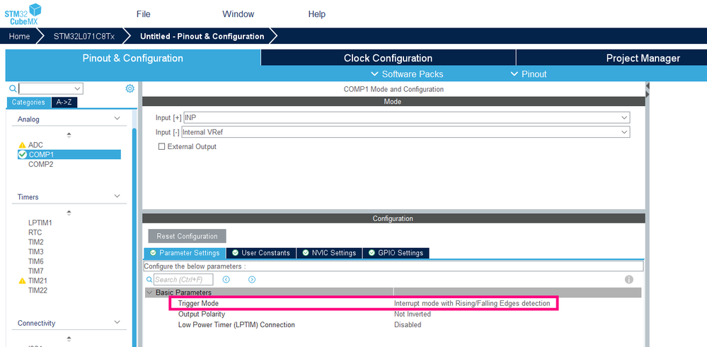

Thank you for the answer @KDJEM.1 ,
Currently I am unable to force the COMP1 interrupt, so I assumed the internal VREF is not turned on- could you help me turning it on in case that is the issue? I have set it as the COMP "-" input source.

Hello @Community member ,
If you use the STM32CubeMX, make sure that select the interrupt mode with Rising/Falling edges detection in Trigger mode as shown in the below figure.
Also, I advise you to get inspired from the available COMP_Interrupt example in the STM32CubeL0 MCU package.
This example may help you in the configuration by following the instructions in the readme file.

Thanks @KDJEM.1 , what I was missing is:
/*##-2- Configure the Vref #################################################*/
/* Enable the Vrefint */
HAL_COMPEx_EnableVREFINT();
/*##-3- Start teh COMP1 and enable the interrupt ###########################*/
if(HAL_COMP_Start(&hcomp1) != HAL_OK)
/* Initiliazation Error */
Error_Handler();
}Now it works.
