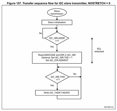

Only process the TXIS flag and write data after you have received ADDR. Until then, ignore TXIS flag. You'll need a software state machine to understand where in the transaction you're at.
2025-11-04 11:47 AM
2025-11-04 1:13 PM
Okay thanks, I understand the idea, but I'm not sure how to ignore the TXIS flag. Based on my code I expect LL_I2C_IsActiveFlag_TXIS to execute only on the repeated start, and never before ADDR is received. In debug mode, if I set a breakpoint at LL_I2C_TransmitData8(I2C1, tx_val) in my TXIS block, I still get data without this line executing which is very confusing to me. How is that possible?
2025-11-04 1:47 PM
The reference manual explains how the flag functions and when it gets set. I understand you don't want TXIS to be set, but that's now how the chip works. You will need to adjust your code to match. The reference manual explains this.
In blocking mode, data will not be sent without TXIS being asserted and data written to TXDR.
