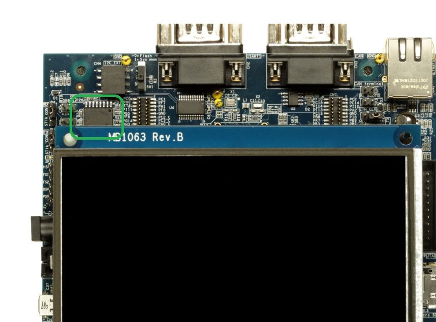

I think the flash on my STM32H753_EVAL2 board rev E has a MICRON logo printed on top.
The Cube Programmer contains an external loader for the M29W128GL for the STM32H743 evaluation board.
So hopefully, this might work. I'll check than as soon as I get the demo compiled.

2024-12-02 11:54 AM
It should also have one or two 16-SOICW parts for a total of 1Gbit (128MB) of Serial NOR Flash, that can map code at 0x90000000 in the address space.
You'd need to build code targeting that space, with code in Internal Flash to bring up the memory interface and pins, and transfer control of the running MCU to the code you've parked up there.
The original H743/H753 EVAL boards were materially the same, the EVAL2 might have a handful of pins reassigned. Check the demo README files.
These should be the immediate proxies
STM32CubeProgrammer_v2.15.0\bin\ExternalLoader\M29W128GL_STM32H743I-EVAL.stldr
STM32CubeProgrammer_v2.15.0\bin\ExternalLoader\MT25TL01G_STM32H743I-EVAL.stldr
