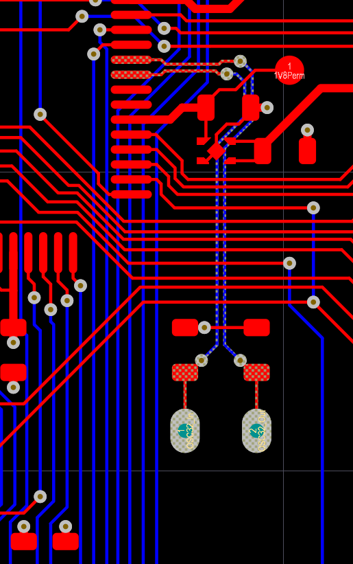

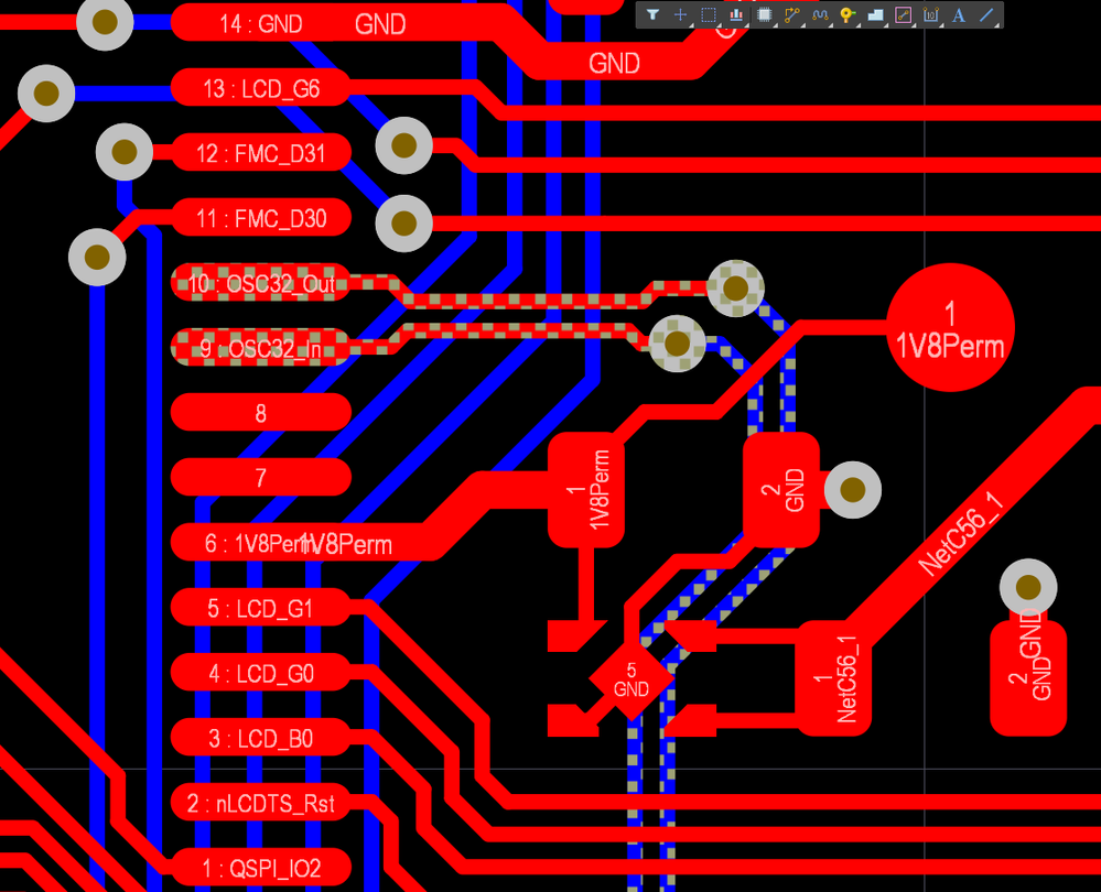

I had issues with the RTC which would lose around 1sec per minute when other peripherals were running.
In my case, lowering the oscillator capacitors did the trick (clearly, I had it easy compared to others!)
I am posting my setup so that it can be re-used.
Here is the board setup:
4 Layer board, 1.6mm:
As you can see in the pictures above, the SDRAM and the LCD tracks are all around the osc32 signals. However, most of them are on a different layer and separated by the ground plane (not visible in the pictures).
I do not have guard around the oscillator and there is no copper flooding under it.
The oscillator tracks are 20mm long.
The ground and power layers are not split under the oscillator signals.
Oscillator capacitors are connected by a common via to the ground plane.
There is no ground separation with the other devices, but there is appropriate decoupling located less than 3mm of each power pin.
I hope it can help!
2021-06-10 9:07 AM
If I understand, the oscillator comes out as a pair, goes below then comes back to the top, then the pair terminates at the capacitors then tracks a little more to the crystal. No doubt adding PCB capacitance, which you adjust for by reducing the values of the capacitors. I would have tried to keep everything closer to the uC pins (or at least the capacitors closer) but that is interesting you show that the oscillator is much more tolerant than any manufacture would admit to. Also that you use the port pins on either side of the oscillator pins rather than connect them to 0V to form a guard ring.
I thought microcontrollers were more tolerant as you have proven. Thanks for the tip. I rarely get work so I write web or blog pages on electronics so I like to use your pictures on my blog, not sure where just now but to show how robust the oscillator is.

I got excited when I read your post and tried similar value crystals and cap's. Unfortunately, it just lowered the RTC frequency on three boards to 0.8xxx Hz - WAY off 1.000000 Hz.
Thank you for posting you results, just wish it worked better for me!
2021-07-20 5:39 AM
There's no way a crystal oscillator to run 20% off its nominal frequency - at that point, it was not a crystal oscillator anymore.
Have we already discussed your ground and VDD arrangement/supply/routing/decoupling?
2021-07-20 6:18 AM
2021-07-20 6:43 AM
It appears you have a ground layer. How does it look like? Is it uninterrupted between the vias from C157/C158 and the GND pin closest to the xtal pins? (note the common via in franck23 ' s post - a nice way to reduce unwanted parasitics, although not critical).
What is the power supply arrangement? What is the power supply voltage? Is VDD/VSS as measured at the closest pins to the crystal pins rock stable?
How is VBAT connected exactly?

The ground plane is cut out under the crystal per the ST app notes, though that did not seem to help anything (was a solid ground plane in earlier versions). Ground layer turned on in the attachment so you can see what I mean. Power supply is 3.3V and looks clean to me. I have a 2.2uF and a 0.01 uF cap on VBATT by the CPU. VBATT comes from a 2032 battery through a diode and 1K resistor. This is really a moot point at this time, I've already added an external RTC to get a reliable clock. I do appreciate the feedback, though.
