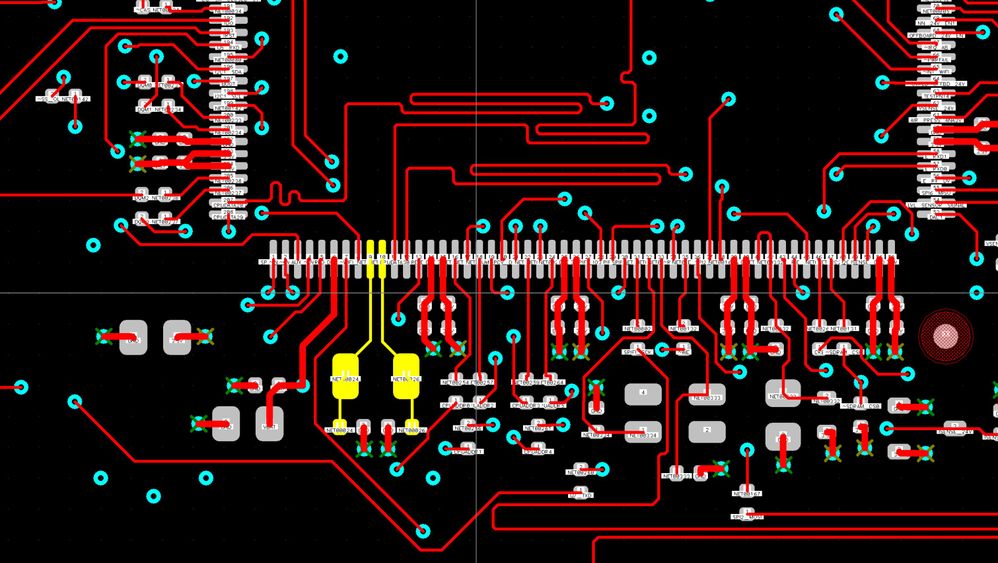

Have several boards with problems keeping time accurately. We calibrate each board in factory test, but some boards have very large errors in the 1 Hz calibration signal and very jittery frequency readings. To make it more interesting, when there is less activity on the PCA the calibration clock output tends to stabilize at a frequency that can be calibrated.
We have tried changing the 32 KHz crystal and load cap's, but that does not seem to have any effect. Boards that exhibit this problem can loose several minutes of time in 24 hours - not acceptable for a modern clock!
Clues:
Anyone have any ideas what we can try to get around this problem? Thanks for any advice here!

Sounds like digital noise gets coupled into the oscillator, whatever the path is (I'd start with suspecting ground routing).
Have you tried to experiment with the oscillator drive strength (RCC_BDCR.LSEDRV)?
What is PCA?
2020-06-17 10:16 AM
What you describe sounds like crosstalk on the OSC line pair picked up from other circuitry on the board. Check to make sure you have no traces running parallel to the OSC pair, and no traces cross underneath. Bring up your other peripherals one at a time, watching the RTC frequency to determine when the crosstalk occurs.
You have checked to make sure the capacitors are matched to the crystal? Do you have a load resistor on one of the OSC lines?

I have tried different drive strengths for the low frequency crystal. Did not seem to affect the operation except for a slight change in frequency - but everything was operating normally when I was testing drive strength. The PCA is a custom board for industrial controls equipment.
We did have trouble with this crystal originally with some boards not wanting to start up (oscillate). I had used a 10 pF load cap crystal, but apparently this CPU prefers a lower capacitance crystal. I wound up using the same crystal (6 pF load capacitance) and load caps (1.5 pF caps) as used on an eval board and have not had any trouble starting up since. I do NOT have a resistor in series with the crystal. Do I need one? The eval board I have did not have any resistance installed (0 ohm resistor).

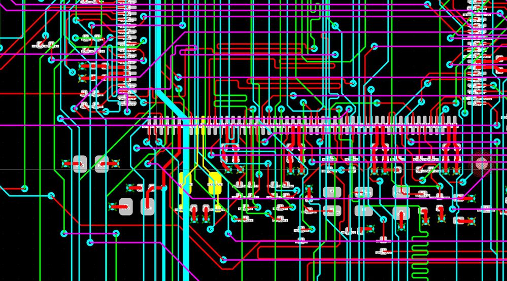

Routing on the top of the board is clean, but there are other traces on other layers below the crystal (see pictures). I'll try to keep that area clear (all layers) on the next version and maybe put a ground pour on the layer just under the top layer.
2020-06-17 11:50 AM
I'd be more wary of the exact ground routing from the capacitors, keeping it separated from any digital ground and connecting it the shortest possible way to the nearest VSS pin.
2020-06-17 11:59 AM
Yes, I'm starting to suspect I need to isolate the crystal more from surrounding traces. AN2867 recommends a separate ground plan under the crystal along with guard traces and I did not do that in this design.
