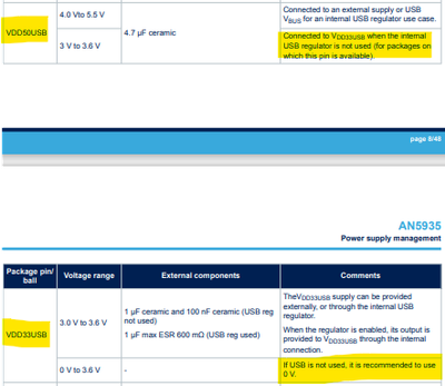

I recommend you to look at AN5935 application note Table 4. Power supply connection.
If USB is not used, it is recommended to VDD33USB 0V.
And when the internal USB regulator is not use , the VDD50USB must be connected to VDD33USB.

We are not using USB. As per my understanding we need to connect Pin-D9(VDD50USB) & Pin-F8(VDD33USB) with GND right?

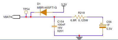

One more query related to VBAT. Please refer below capture and provide your feedback for VBAT. Diode D1 and other components are, ok?

Yes you are right.
-> One more query related to VBAT. Please refer below capture and provide your feedback for VBAT. Diode D1 and other components are, ok?
Please don't ask many questions in the same thread. I recommend you to create a new post related to VBAT.
