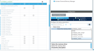

So is this what the "EXTMEM_USER" Option is for in cubeMX?

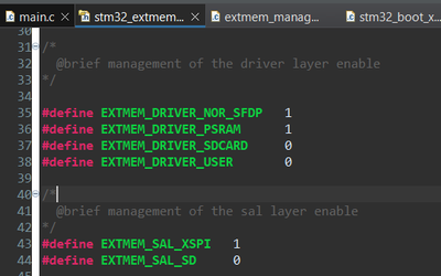

From my understanding, you need to set 2 memory sections, one for code storage (external NOR flash, in our case), and one for code execution, that the instructions in NOR get written to. But there doesn't seem to be an option in Cube MX, or in the code generated. #defines only seem to exist for the memory options on the list.

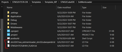

I do see that two .ld files are generated in the XIP template project, Is there one here that only executes from internal Ram, instead of external?
Because I would still like my instructions to be stored in external flash, since the internal flash on the STM32H7S7 is very small. I didn't think there was a way to execute instructions directly from external flash, as this option in Cube MX of marking memory 2 to "none" does not allow you to generate output code. So it seems strange that one of these would be targeting just the External flash for execution.
Would you be able to go into more detail on these two files? Maybe my understanding of this whole system is just incorrect.
