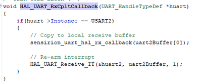

However, after connecting a sensor that we know is responding (tested through a different F7 board and on the same board with an oscilloscope), I was not able to get anything when using the HAL methods (either with interrupt, or in the simple blocking mode) :
Here is our configuration :
Nothing really worth mentioning, aside from the PD6 pin which we had to unassign from the Ethernet connectivity (I believe it is used by a Eth clock by default... but we didn't get any warning, and the Ethernet seems to still be working fine)
Transmission works well (synchronously):
However for the reception, we sometimes get just one character with the callback of the interrupt... sometimes none. Which is a bit frustrating (when we know signal is going through the RX pin, and that the DE ping is working as expected). I also tried the blocking call, which returned a timeout, after a reasonable wait period.
