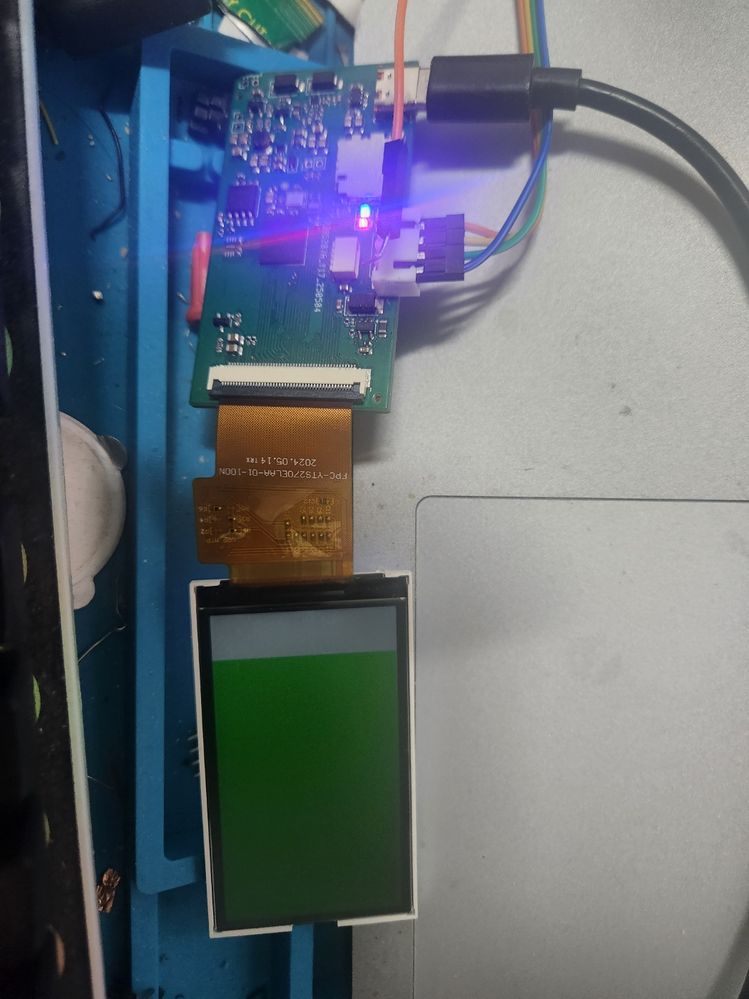

2025-05-16 2:53 AM
I resoldered STM32H7B3VIH6 chip, and rewrote LCD's initialization program, then I could get LCD working.
Signal errors was soldering problem. PWM output for dimming LCD backlight is working well also. thanks!

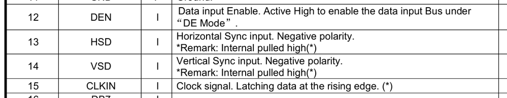

Could you please check the data enable polarity configuration?
The LTDC control signals (HSYNC, VSYNC, DE, and LCD_CLK) polarities must be configured respecting the display specifications.
Note: Only the DE control signal must be inverted versus the DE polarity indicated in the display datasheet. The other control signals must be configured exactly like the display datasheet.
I recommend you to look at AN4861 and precisely section 7 LTDC application examples and get inspired to configure the LTDC.
Thank you.
Kaouthar
2025-05-14 9:46 AM - edited 2025-05-14 11:22 PM
Yes I did check it already and its applied. my LCD datasheet exactly requires active high, so it's configured correctly I think. Currently pixel data signals(R0-7,G0-7,B0-7) are not working, just LOW. Is there an API to refresh or reload LTDC? or is there an API that must be called to start LTDC's pixel outputs?
DE: Active High, HSYNC + VSYNC: Active Low, CLK: Rising Edge.
LCD controller is ILI8961, so `DEN` pin of LCD will have positive polarity as default. and I wrote small program to initialize ILI8961 and it setup RGB888 interface on LCD.
