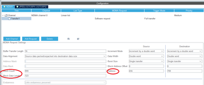

2024-08-27 12:05 PM - edited 2024-08-27 12:19 PM
We didn't really find the error, but we are now using MXcube for configuration.
There are some parameters we don't understand:
In mxCube, we can enter the source and destination address along with “block Count” and “Block data Length” but nothing is done with these values during code generation.
Is this normal or a bug in mxCube?
The “buffer transfer length” what does this value mean?
hmdma_mdma_channel0_sw_0.Instance = MDMA_Channel0;
hmdma_mdma_channel0_sw_0.Init.Request = MDMA_REQUEST_SW;
hmdma_mdma_channel0_sw_0.Init.TransferTriggerMode = MDMA_FULL_TRANSFER;
hmdma_mdma_channel0_sw_0.Init.Priority = MDMA_PRIORITY_MEDIUM;
hmdma_mdma_channel0_sw_0.Init.Endianness = MDMA_LITTLE_ENDIANNESS_PRESERVE;
hmdma_mdma_channel0_sw_0.Init.SourceInc = MDMA_SRC_INC_DOUBLEWORD;
hmdma_mdma_channel0_sw_0.Init.DestinationInc = MDMA_DEST_INC_DOUBLEWORD;
hmdma_mdma_channel0_sw_0.Init.SourceDataSize = MDMA_SRC_DATASIZE_DOUBLEWORD;
hmdma_mdma_channel0_sw_0.Init.DestDataSize = MDMA_DEST_DATASIZE_DOUBLEWORD;
hmdma_mdma_channel0_sw_0.Init.DataAlignment = MDMA_DATAALIGN_PACKENABLE;
hmdma_mdma_channel0_sw_0.Init.BufferTransferLength = 16;
hmdma_mdma_channel0_sw_0.Init.SourceBurst = MDMA_SOURCE_BURST_SINGLE;
hmdma_mdma_channel0_sw_0.Init.DestBurst = MDMA_DEST_BURST_SINGLE;
hmdma_mdma_channel0_sw_0.Init.SourceBlockAddressOffset = 0;
hmdma_mdma_channel0_sw_0.Init.DestBlockAddressOffset = 0;
if (HAL_MDMA_Init(&hmdma_mdma_channel0_sw_0) != HAL_OK)
Error_Handler();
