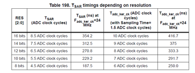

2024-08-16 12:22 PM
Thanks.
We try to let sample the ADC above the 1Mhz, but there is somethings wrong.
- The ADC clock is 48Mhz.
- The clock prescaler is: divided by 1
- The ADC has a resolution of 16 bits
- The Sample Time is 32.5 Cycles.
When we now caculate the sample time:
TCONV = Sampling time + 8.5 ADC clock cycles
TCONV = 32.5 + 8.5 = 41 cycles or 48 / 41 = 1.170 M samples.
For the ADC conversion we us a DMA in circular mode with a buffer size of 1000 samples.
Than we us the HAL_ADC_ConvCpltCallback() function to indicate when the 1000 sample are taken.
In this interrupt we let toggle an output port.
The frequentie on the output pin should be:
Freq I/O pin = Sample freq ADC / 1000 / 2 (2 here means, factor 2 due togglling)
Freq I/O pin = 1.170 mega sample / 1000 / 2
Freq I/O pin = 585.3 Hz.
We measure 292.7Hz on the I/O pin.
This is a factor 2 slower than calculated.
Can you explain us why this is a factor 2 slower? (sample rate is 585Khz and not 1.17 Mhz)

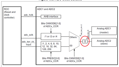

2024-08-16 1:24 PM - edited 2024-08-16 1:27 PM
Hmmm... look in RM, ADC block picture, some ADC have internal /2 division, so running on half clock rate. Maybe depends on version of chip, V or Y or so. Check this.
And just try with shorter sampling time, to get about 24 cycles, and see, what happens.

2024-08-17 1:19 AM
There should be a single letter, V or Y or Z...
Show a pic of the chip, maybe it's there.
But that's no problem, just to know the divider is there, then you can include it in the calculation for ADC clock.
And anyway, for getting a certain ADC rate, using a timer to trigger is the best way, to get it running at a certain frequency.
2024-08-17 3:08 AM
Thanks for the information
We cannot find the the single letter, V or Y or Z... on the chip.
But we found this in the datasheet. So the Clock of the ADC is always divided by 2.
For the 1 M sample rate we using now a timer and this works fine.
