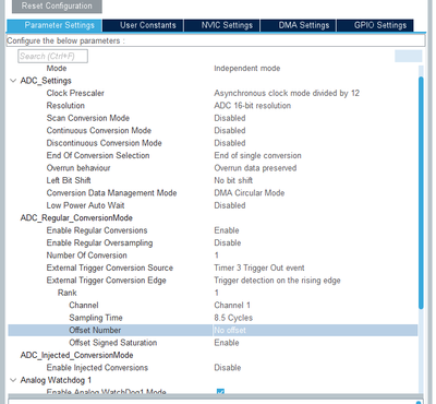

We are using the ADC2 in 16-bit resolution at 100 kHz, operating in differential mode.
The internal voltage reference (Vref) is set to 2.5 V.
A 1 kHz sine wave with a peak-to-peak voltage of 2.5 V (ranging from 0 V to 2.5 V) is applied to the ADC inputs.
Based on this setup, we expect the ADC output to vary between 0 and 65,535 after conversion.
However, our actual measurements show values ranging approximately from 16,787 to 50,000.
This suggests we are missing about 16384 counts on the lower and upper end.
When we rescale the measured values to the full 0–65,535 range, it appears as though the ADC is working with a 3.3 V range instead of 2.5 V.
Is this expected behaviour, or is there something we might be doing wrong?
See attached files for the configuration.

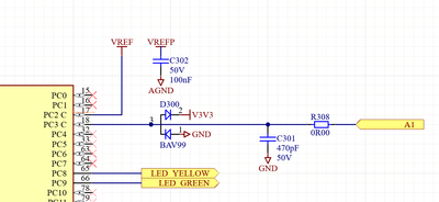

Our VREF of 1.25 (2.5V / 2) is connected to PC2

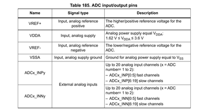

So whats at pins Vref+ and Vref- ? (this range it will convert)
Ok, and you connected to vref+ ?  --->

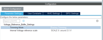

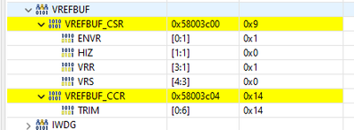

The vref + is connected to the Vrefbuf.
This is internally connected with the VREF+,  mode ENVR = 1 and HiZ = 0

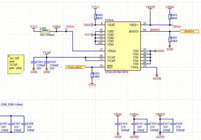

Now it is a 100 pin version of the STM32H7B0 and this MCU has no Vref+ and Vref- inputs

ps: R401 isn't assembled

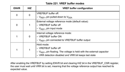

Your VREF+ is connected to VDDA, which is 3.3V. If you want to use VREFBUF, you will need to disconnect this pin from VDDA and add a 1uF capacitor. Looks like you have the caps, just need to disconnect R401.
You cannot use VREFBUF when VREF+ is provided externally.
first check with DMM : whats on Tp 400 + 401 ? (when program running)

R401 is disconnected (not assembed)
Dear,
On test point TP401 we have 2.506V
On test point TP400 we have 3.301V

Check your settings....and from rm for your 100pin (!!!) : can vref+ be switched to vref pin.
