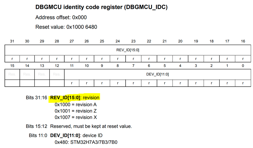

I'm using STM32H7A3 MCU and I want chip current version of chip to identifies the revision of the silicon chip.
So how may I identifies for STM32, If anybody knows the way to get this, then please help me.

The REV_ID field within DBGMCU->IDC provides the hardware version of the chip.

Thank You so much TDK.
