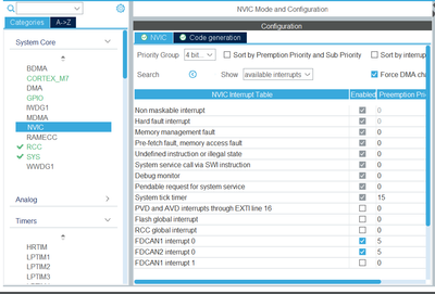

Hi, did u fix it? I have STM32H750XBHX with same problem...
I also have a callback for CAN1 but it is not called at all. I have an interrupt set up in NVIC....
I checked via FreeRTOS if receiving works and here surprise, receiving and sending frames from task level works very well....
