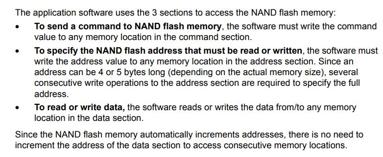

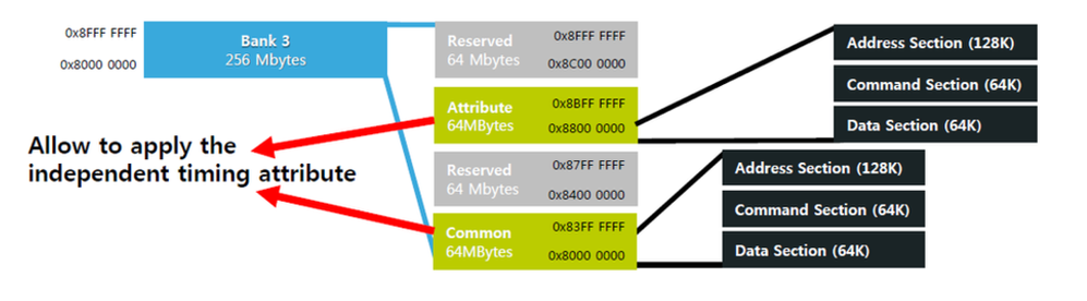

My biggest lack of understanding is coming in how in the world do I program this thing. I'm reading in the reference manual that there is something called the "common" and "attribute" memory space. These spaces are further split to "address", "command', and "data" sections. This is my main area of confusion. In C, do I just read and write to the address section? If so, what do I write, my data or an address? If I write the address there, how does it tell what data I want written? Is it linked or something to an address in the data section? Also what is the command section?
^ img from here: https://community.st.com/t5/stm32-mcus/how-to-configure-the-fmc-peripheral-to-interface-an-stm32-mcu/ta-p/705805
I'm reading this in the data sheet and its confusing me ^
