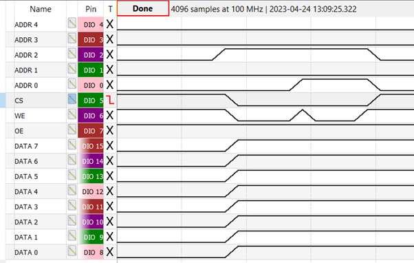

I am using the DMA2D to transfer colour data to an external SRAM using the FMC with an 8-bit parallel hardware setup. I can use the following line of code on the CM7 CPU to write to any in-range address (0x68000000 base) with any pointer type (uint8_t, uint16_t, uint32_t, uint64_t) with no issues:
uint16_t * const externalRAM = (uint16_t*)0x68000000;
externalRAM[INDEX] = 0xFFFF;The logic analyser output of a write with INDEX set to 2U (No issues):
To produce no issues when writing with the CPU, the MPU has been used to set up the external SRAM buffer region as non-cacheable (see config below). If this is NOT done, the FMC will write to a full 64-bit region even if a single-byte write attempt is made. The remaining bytes will be corrupted (suspected cache related).

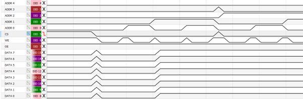

When using the DMA2D to write to the external buffer (with the MPU configured correctly), if the start or end addresses of a transaction don't align with a 64-bit boundary, the remaining bytes in that 64-bit region will be corrupted. This does not occur if the internal memory is used for the target buffer. See the following logic analyser output when starting a DMA2D transfer with the target address set to 0x68000002 and colour data set to 0xFFFF. The FMC is writing garbage data (0x00) to the first 2 bytes of the 64-bit region. If the DMA2D target address was set to 0x68000003, the first 3 bytes would become corrupted.
