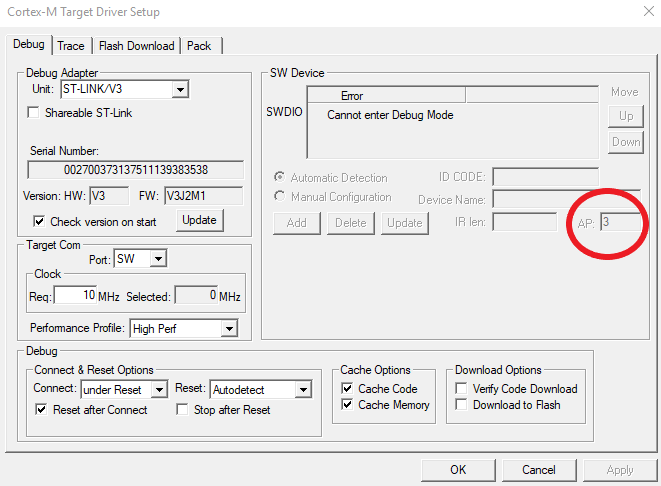

Hello @TOlli
You can refer to section 2.1 Access port of AN5286 "STM32H7x5/x7 dual-core microcontroller debugging"
CM4 is accessible on access port 3 (AP3).
You can see on this figure an example of ST-link configuration.
