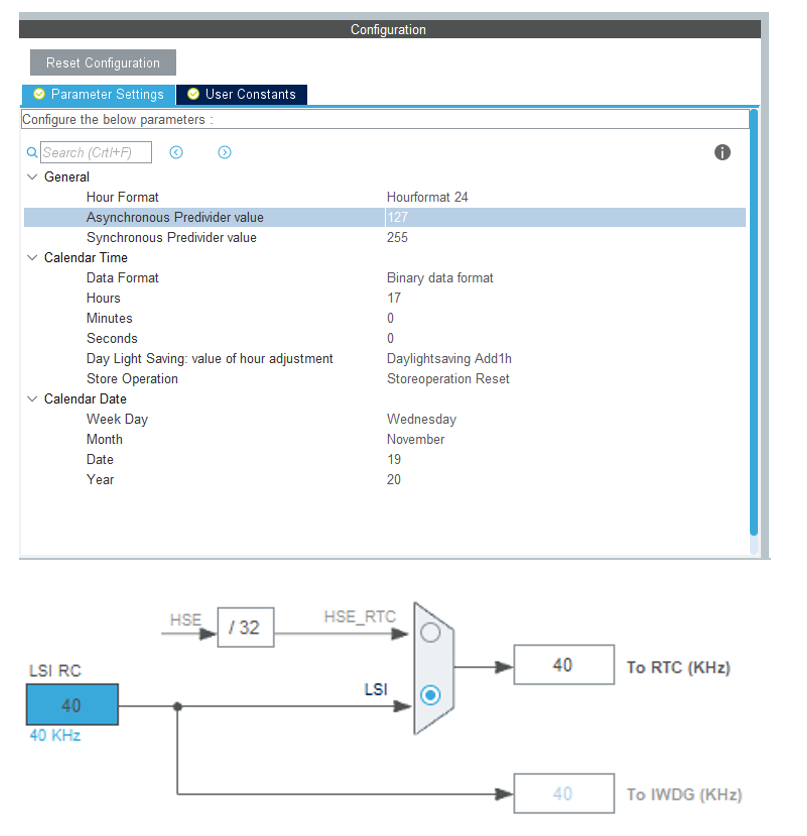

I am measuring the 3V across VDD (Vbatt) and Gnd terminal when the chip is powered by external battery. Yes, it might also be a software problem. I created the skeleton using STM32CubeMX and have attached a snippet of my configuration.

First of all: in STM32CubeMX you have selected LSI as clock source, whose main usage is to clock the IWDG (Independent Watchdog), which is required for safety applications, where accuracy doesn't matter. The LSI is an independent but rather imprecise clock - the datasheet of the STM32F042 mentions 30...50kHz, i.e. +-25%. You can get an error of +-6 hours/day (yes, six hours) using the LSI instead of the more precise LSE for the RTC.
But back to your main issue: it is probably raised by a feature (not a bug :smiling_face_with_smiling_eyes:) of STM32CubeMX, which sets the predefined values for time/date and so on in the skeleton program, so it always overwrites (resets) the current RTC values after a reset. This predefined behavior can be useful i.e. when debugging a program, but is somewhat inappropriate when introducing an application being rolled out. A solution compatible to the workflow of STM32CubeMX and STM32CubeIDE has already been discussed here.
