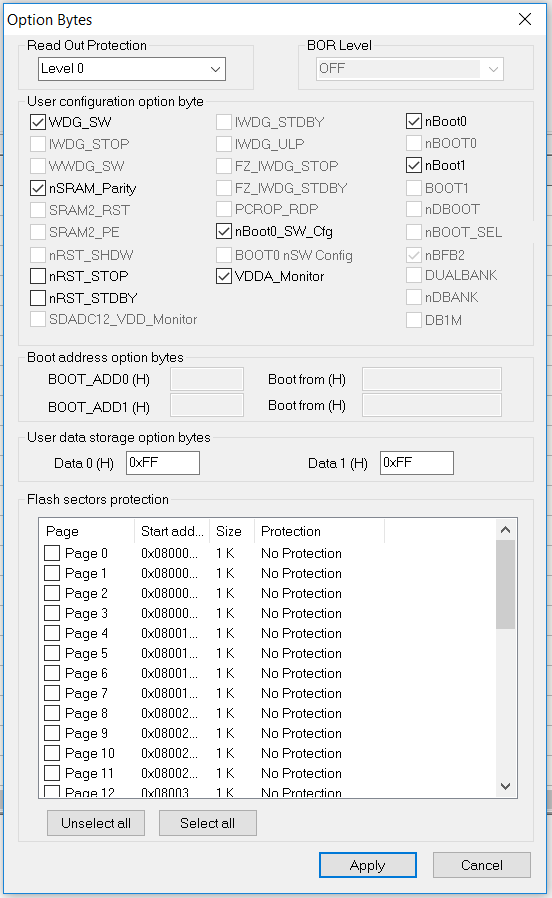

I just made a discovery. By forcing reset line low during SWD ''negotiating'' I am able to connect to and program the target via STLINK Utility. I can also do this when going into debug mode in SW4STM32, but the connection fails when I press Run.
Also forgot to mention that the other target I managed to program normally did not have the reset line connected at all. STLINK utility probably fell back on programming without reset?
So here I managed to read out my option bytes. I am investigating it now to the best of my knowledge, but you may chime in if you see anything:
2017-01-15 1:10 PM

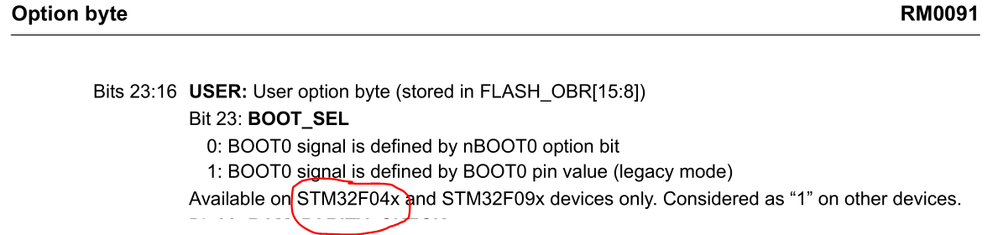

This should maybe go into a new thread, but why is nBOOT_SEL greyed out in the image above? Reference manual says this option is for choosing whether pin or software puts you in bootloader mode:
