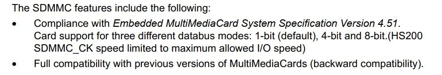

2020-10-05 6:14 AM
And I went back again into the HAL driver.
Does the HAL driver actually support 4 bit wide bus or not?

2020-10-05 6:19 AM
One bit mode is forced as eMMC starts in one bit mode. You can switch to 4- or 8- bit mode afterwards. CubeMX will generate code that does this for you, although the eMMC support with HAL is not great.
2020-10-05 6:27 AM
Hi TDK,
I noticed that the init sequence is done correctly at 400kHz with 1B.
But afterwards, that code referenced above is the last thing that is called before entering normal operation. So I assume that the 1B mode is forced in fact. Or at least I can't find anything that would suggest otherwise.
Maybe I should call the configuration function again myself.
Maybe this is just a work in progress and I need to do this by myself.
