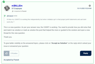

@Pranoti wrote:
Hi Now my USART3 is working fine independently but when i initialize spi1 in that project printf statements and uart dont work why ?
This is a new question. As per your answer now, the USART is working. You need to provide how you did solve that and mark it as solution or mark as solution the post that helped the more or guided to the solution and open a new thread for this new question.
Thank you.
