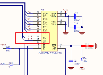

CLE and ALE NAND memory signals are multiplexed respectively with addresses A16 and A17.
You can inspire from STM3210E-EVAL schematics from here:
