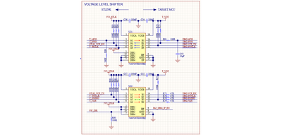

2026-03-11 2:04 AM
This is level shifter version for some STLINKV3E solution.
