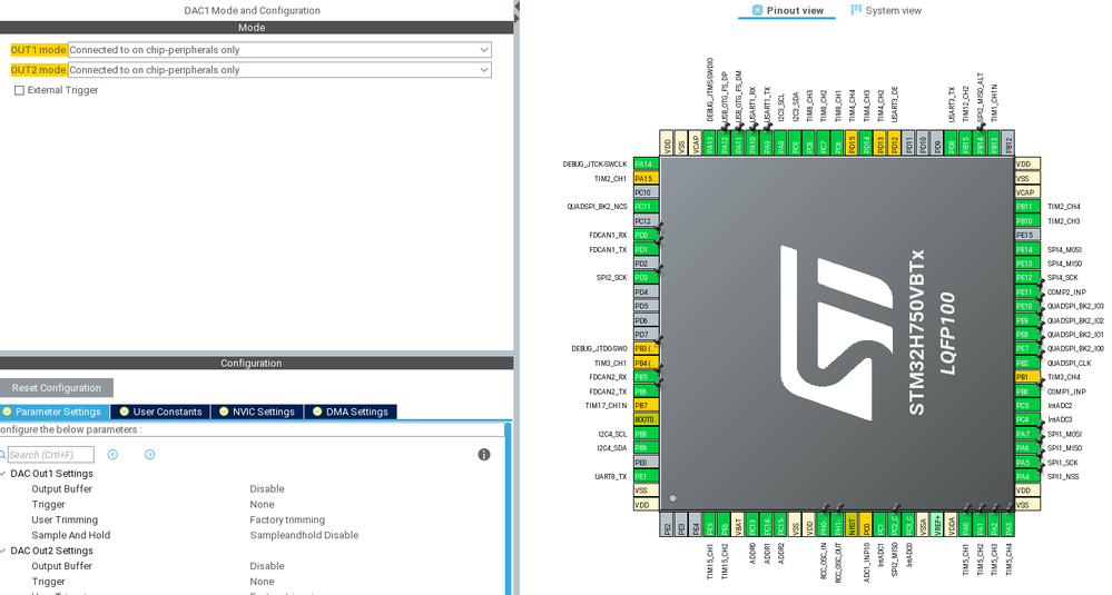

I currently have the MCU's PA4 and PA5 set up for SPI AND the DAC output set as on-chip peripherals only, but contrary to the errata, the SPI signals can be seen properly in the pins.
(In my case the DACs are used as internal INP- for the COMParators.)
Of course I am happy I don't seem to have the issue :), but due to the critical nature of the system being developed, I need to know if this errata really does not apply any longer or the exact steps needed to reproduce it.

A bit more info:
HAL_DAC_Start(&hdac1, 0);
HAL_DAC_Start(&hdac1, 1);
HAL_DAC_SetValue(&hdac1, 0, DAC_ALIGN_12B_R, 0x7ff);
HAL_DAC_SetValue(&hdac1, 1, DAC_ALIGN_12B_R, 0x7ff);
printf("DAC[0]=0x%f", HAL_DAC_GetValue(&hdac1, 0));
printf("DAC[1]=0x%f", HAL_DAC_GetValue(&hdac1, 1));
and I can see the values correctly changed in the DAC DOR1/DOR2 registers.
Also worth noticing that in my initialisation list the DAC comes after the SPI1, i.e.
MX_SPI1_Init();
MX_DAC1_Init();
Since the DAC is only being used by the COMP1 and COMP2, I cannot really see if the voltage value is really close to 0x7ff, but the SPI_CLK and SPI_NSS are definitely present in the pins!
