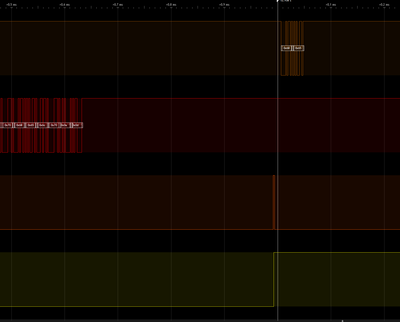

Above image shows the error:
Trace 1 (orange) shows the TX line of UART1, where only two bytes are transmitted.
Trace 2 (red) shows data on RX line. One can see that no RX takes place at the same time as TX.
Trace 3 shows a debug pin, it is triggered once when DMA transfer is started.
Trace 4 shows another debug pin. It is set HIGH when DMA transfer is started and is set LOW in DMA Transfer finished interrupt triggers (which never happens, because DMA never finishes its transfer, because UART stops emitting data).

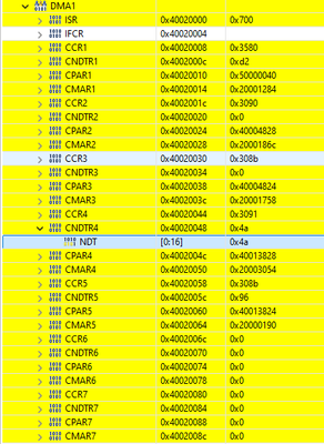

A look at the peripheral registers shows the following:

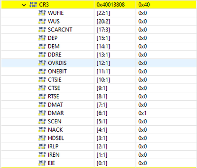

UART 1 CR3 shows that DMAT is off. It was not set to off by software anywhere!

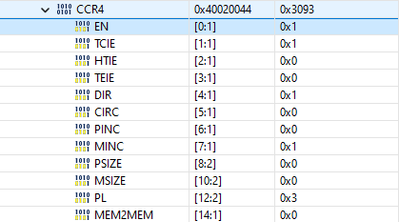

DMA1 Channel 4 Configuration register shows that DMA channel is enabled.
DMA1 Channel 4 count down register shows that there are still 74 (0x4a) bytes remaining to be transmitted.

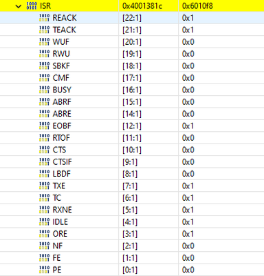

USART 1 interrupt and status register:
Overrun error (ORE) Flag is active, however this should only flag received data and should definitely not disable DMA for the transmit stage.

I know this is an almost one year old thread which resurfaced only because of what is probably AI generated nonsense (maybe as part of attempt to inject a spamming link). However, here IMO the issue is software inadvertently clearing DMAT, as @TDK said above. This won't be at an expected place, i.e. wherever DMAT really gets cleared, but anywhere else where USARTx_CR3 gets written. I'd bet that write is non-atomic, which together with interrupt-based program (and RTOS is nothing but threads interrupting each other through the OS's timer) may easily lead to such "bit loss".
Btw., data breakpoints (a.k.a. watchpoints) *can* be placed at peripheral addresses, although as any other debugging tool, it's not a panacea, expecially if there are many intended writes to that peripheral, as is the case here.
Also, in 'F3 (i.e. CM4), APB peripherals are in the bit-band-able area, which may be a way to write bits in the peripherals' registers in a way which is atomic from the interrupts/software perspective.
