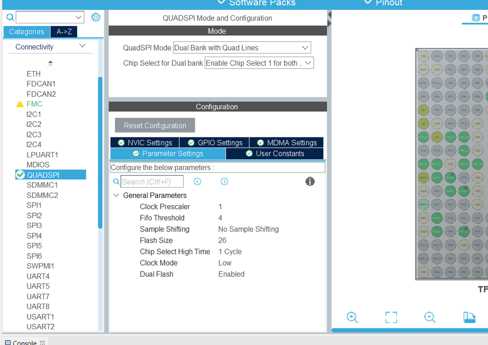

2022-01-13 1:59 AM
Hello @Andrzej Węglowski,
Sorry for my late response!
I found the solution. You need to configure the QSPI as dual bank as mentioned in the picture. If you check the RM for the STM32H750DK you will find that it has 2 NOR Flashs of MT25QL512 so you need to configure it like that and it worked fine.
Ayoub
