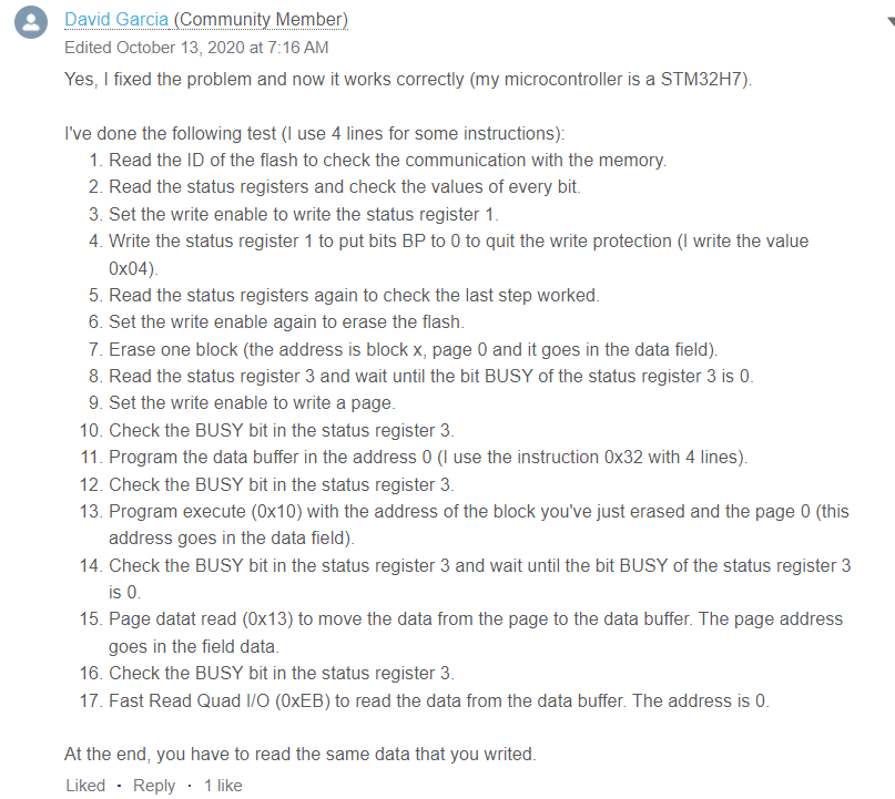

David Garcia (Community Member)'s answers are very helpful. In this question QSPI of STM32L496A, the codes found here are all working, I followed the instructions.

I tried to follow instructions written by David Garcia, but didn't work.

In the other thread I suggested the consistent use of clearing methods for auto/local variables as this can resolve a lot of odd / unexplained issues when interacting with the HAL library code.
