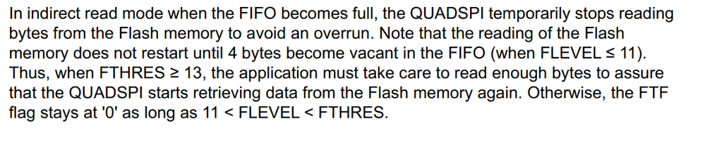

I read in the reference manual that the STM32H750 has a 32-byte fifo. FTHRES is the FIFO buffer and FLEVEL indicates how many values are stored in the FIFO buffer. The reference manual also explains that after the FIFO is full the QSPI peripheral temporarily stops reading bytes (qspi_clk is suspended) to avoid an overflow and the byte reading process resumes after reading 4 bytes from the FIFO. But this shows FLEVEL <= 11 and I don't understand this because FIFO has a capacity of 32 bytes. So FLEVEL must be less than or equal to 28 bytes.
Also the reference manual explain that for FTHRES is greater or equal than 13, I need to read fifo in order to continue reading operation, and again this does not match with fifo size.
Am I missing something?
