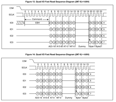

But I check the sequence diagram is, and maybe it includes 'M0-M7' clock-bit?:

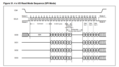

I found a table about the dummy clocks.

That dummy cycle is actually adjustable by a register which I don't remember its name!
