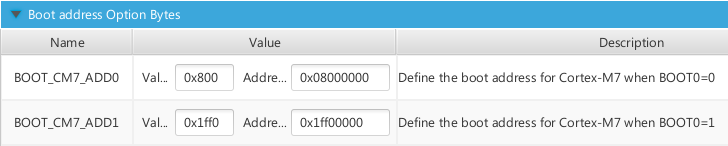

Also, reading the Option Bytes with STM32CubeProgrammer I get these values:
So I think that it is correct to put my code at 0x08000000. About the GPIO clock enable, I am enabling it with the "RCC_AHB1ENR |= 1". When I switch on the board with BOOT0 pin at 3.3v y can connect the booloader with DFU using STM32CubeProgrammer but when I switch on the board with BOOT0 pin to 0v nothing occurs.

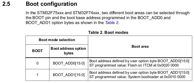

I am also a bit confused because, in the reference manual of STM32H750 y get this:
So I don't know why my chip have these options bytes (may be a second hand chip), but the fact is that the value I read of BOOT_ADD1 using STM32CubeProgrammer is 0x1FF00000 and that is a reserved area! :| and the other fact is that that BOOT_ADD1 runs ok because I am connectin using STM32CubeProgrammer using DFU!
Any explanation?
You want to place your image at 0x08000000, the first things there are NOT CODE, but vectors (addresses to something else..)
ie
.word 0x20002000 // Some RAM for Stack
.word 0x08000009 // First Instruction, THUMB
// 0x08000008
// RCC_AHB1ENR |= 1;
ldr r3, =0x40023830
ldr r2, [r3, #0]
orr.w r2, r2, #1
str r3, [r3, #0]
The H750 is not an F750 or F740 device
