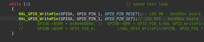

just i was not aware, H7 could be slow on port access, i try : have DevEBoard here, for my audio player fun project...
simple 1. test: set port by HAL call (slow...maybe. i know. )
now H743 at 250MHz clk , caches on, -Ofast , port speed set: low ->
so 50ns with HAL. next direct write ..

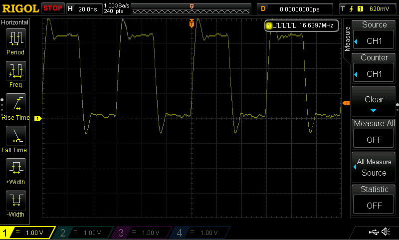

2022-11-01 4:53 AM
direct write about same : 50ns lo, 50ns hi.
then
optimzed clock tree, to get (maximum) 200MHz on AHB4 , where ports are.
and direct write >> GPIOA->BSRR = 0x00000002;
so 30 ns seem optimum with H743. :|

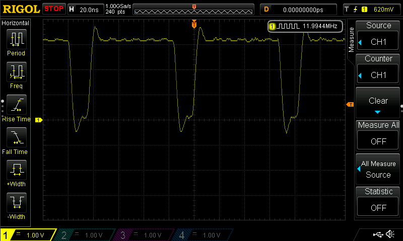

just for fun: test write port lo-hi-loop on stm32F303 (M4 core) - Ofast :
about 15ns , at 72MHz clk. =)
(1 clk 13,8ns at 72 MHz)
and while-loop is 100ns total, because core much slower than H7
same on F303 without optimizer , -O0
about 340 ns !!
and funny, with -O2 faster than -Ofast :
about 83ns , 1 tic faster than fast. ;)
so optimizer -O2 speed up 400% in this small loop. :astonished_face:
