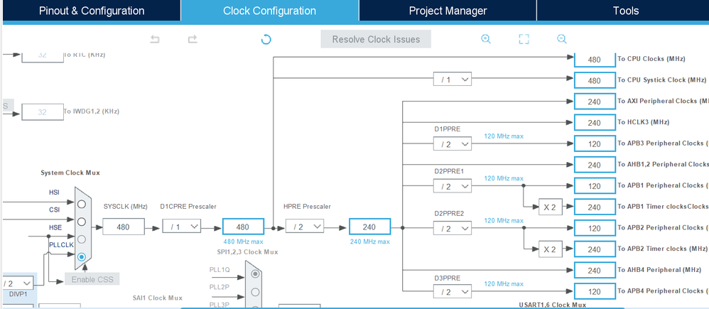

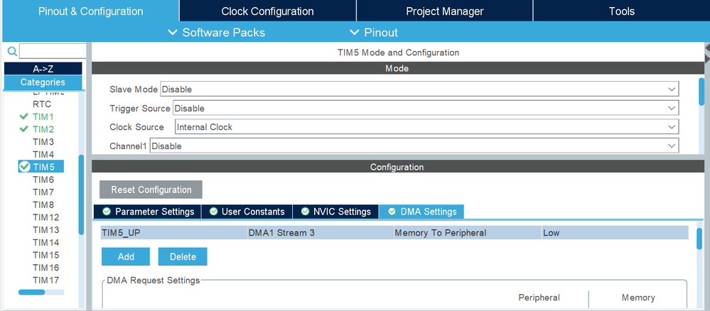

STM32H750 Discovery kit Clock Generation on GPIO Pin @ 10Mhz speed using DMA (Memory to peripheral copy).
Timer 5 is configured for 10 MHZ speed to trigger the DMA. In the DMA transfer (Memory to Peripheral) we are using the GPIO PB4 for clock generation. Clock is generated but it is not proper. We would like to the know the reason for it and any precautions/setting we have to follow to get the proper clock.
Clock Setting

//Timer Clock 240 MHZ .//Set 20 MHZ speed
htim5.Init.Prescaler=0;
htim5.Init.Period = 12-1;
//Enable timer
HAL_TIM_Base_Init(&htim5);
__HAL_TIM_ENABLE_DMA(&htim5, TIM_DMA_UPDATE);
__HAL_TIM_ENABLE(&htim5);

dataTransferStatus = HAL_DMA_Start_IT(&hdma_tim5_up, (uint32_t)gpioFirstBuf, (uint32_t)&GPIOB->ODR, 24);
