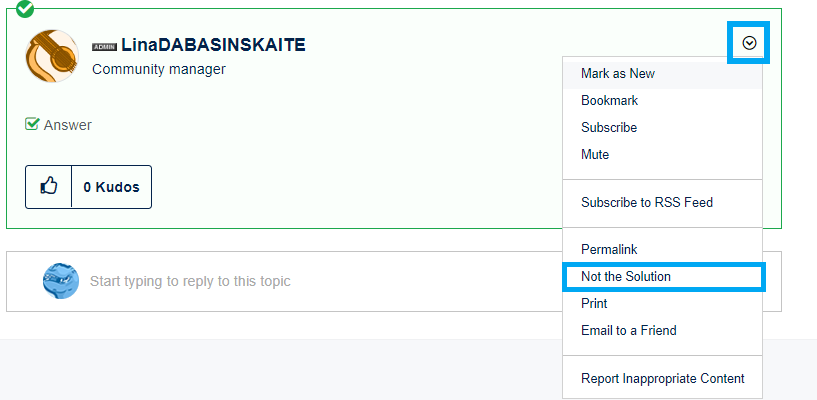

Hi @dc_matt,
Welcome to the ST Community and thanks for reporting this.
If you click the “Accept as Solution” by mistake, you can revert the action by choosing “Not the Solution”.
Important: to apply the action of “Accept as Solution” or revert to “Not the Solution” is permitted only to the author of the post and the community moderators.
If you face any difficulties, please mark the post “Report Inappropriate Content” and the forum moderators will take the respective action.
You can find more on this feature here: Help others to solve their issues
In the future, you can share your feedback or questions about the community platform here: Feedback forum.
Let me know if there is anything else you need,
Lina - ST Community team
