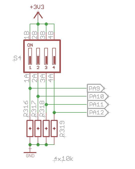

I have configured several GPIO as inputs with no pull-up/ no pull-down. The pins are wired to an external 10k pull-down and a DIP-Switch which is directly connected to +3V3. (screenshot below).
When all switches are off, I read and measure +0V on my pins. If I set one switch to active so it connects +3V3 to the MCU-Pin this pin reads a high and I can measure +3V3 with an osciloscope. The weird thing is now that I can also measure something between +1.7V and 2.9V on the other lanes, even though thex should be low and pulled down by the 10k resitor. I tried to work with the internal pull down of the mcu with the same results. I tried to configure 3 of the pins to output and set them to low. The remaining pin was set as input. After I switched the respective switch to high I got the same result and even the pins which should drive the lanes active low got some voltage somewhere between 1.7V and 2.3V.

2025-01-22 1:52 AM
Looks like there is no ground connection to the pull-down resistors. The resistors are not really needed, as the internal port pull-down is enough.
