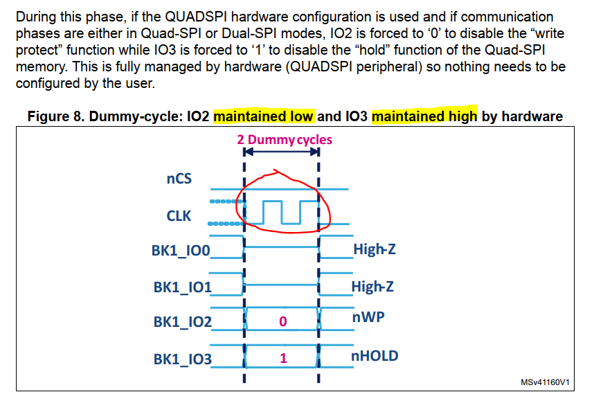

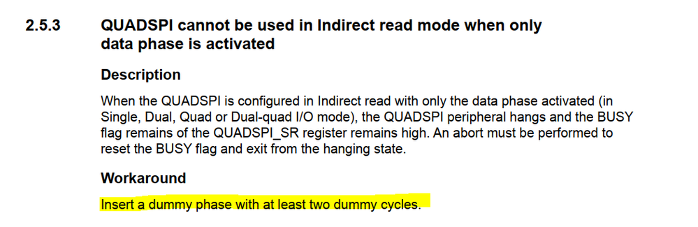

The errata suggest to "insert a dummy phase with at least two dummy cycles" when using indirect data read mode.
However, according to the documentation of the dummy cycle phase (AN4760 rev 3, section 3.1.4 and figure 8 ) states that in the dummy phase the clock continues to oscillate. So if used during read transaction, the data would be clocked in from the device and subsequently lost.
Moreover, the data lines 2 and 3 are driven during these cycles.
Am I reading this wrong, or is the workaround not suitable for the intended purpose of read operation ?
