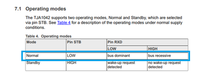

3- What is the level voltage on STB pin of the CAN transceiver? STB pin should be set to LOW for normal mode. According to the datasheet:
The voltage of STB is low only.

3- The voltage of STB is low only.
-> Are you sure it's connected to GND and not kept floating?

> 3- What is the level voltage on STB pin of the CAN transceiver? STB pin should be set to LOW for normal mode. > > According to the datasheet:
You can look it up in the transceiver's datasheet. But the signal name highly suggests "Standby", which would effectively turn the CAN access for the device off.
