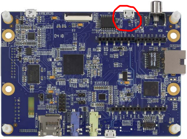

Hello, I just got STM32H747I-DISCO board. I have stlink-2 and I guess I cannot program this board with stlink2. Do I need to get STLink-3 or STLink-4 in order to program this board? In the description it says: Board has a built in STLink-v3 inside of it. Does it meanI " do not need an external programmer to program it"? If yes how will I do that without an external programmer. Thanks beforehand.
2020-01-15 12:38 AM
Connect the USB port marked ST-Link V3 to your PC to access the built-in ST-Link
2020-01-15 1:02 AM

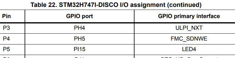

According to user manual led 4 is P5 pin so I don't know why first error exists. And I have no idea what is the second error.It is the first time I am using one of these boards. I might be done something nonsense.
2020-01-15 3:55 AM
Where did you cut-n-paste the source code from? Seems like it pulled non printable characters.
P5 ?? Use the the right pin designation, not the BGA ball coordinate.

I am not sure, in the user manual it says pin P15. (see the image)
