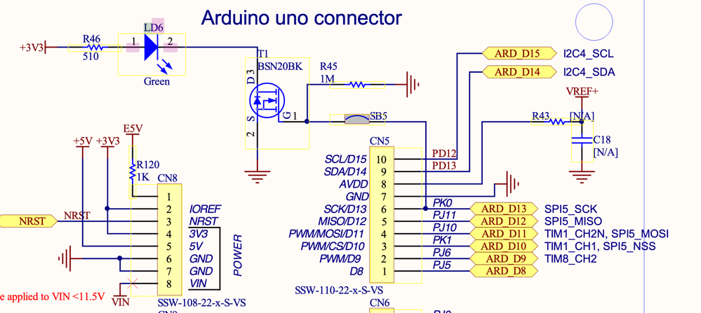

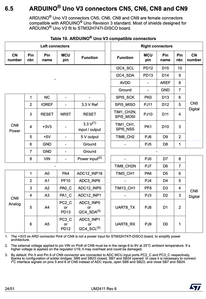

@TDK I believe these are the correct pins, image from user manual included below.
