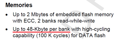

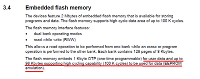

You didn't mention which H5 part number you're using.
But in the case of STM32H56x and STM32H573, there is a dedicated part from the flash which can be used for EEPROM emulation. 48KB per bank:

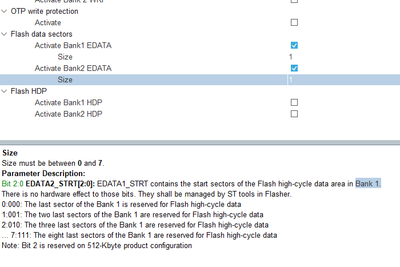

Thanks for your response SofLit, I am using the Nucleo-H563. Using MXCube, the detail of the description led me to confusion
