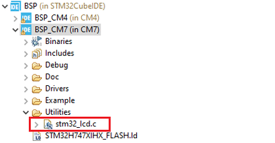

1- Was stm32_lcd.c already included in the project?:
2- Check the availability of stm32_lcd.c under the path \Utilities\lcd\stm32_lcd.c
2023-09-12 12:44 AM
yes stm32_lcd.c is included in utilities folder
2023-09-12 2:43 AM
Included in the project as well?
2023-09-12 2:45 AM
yes

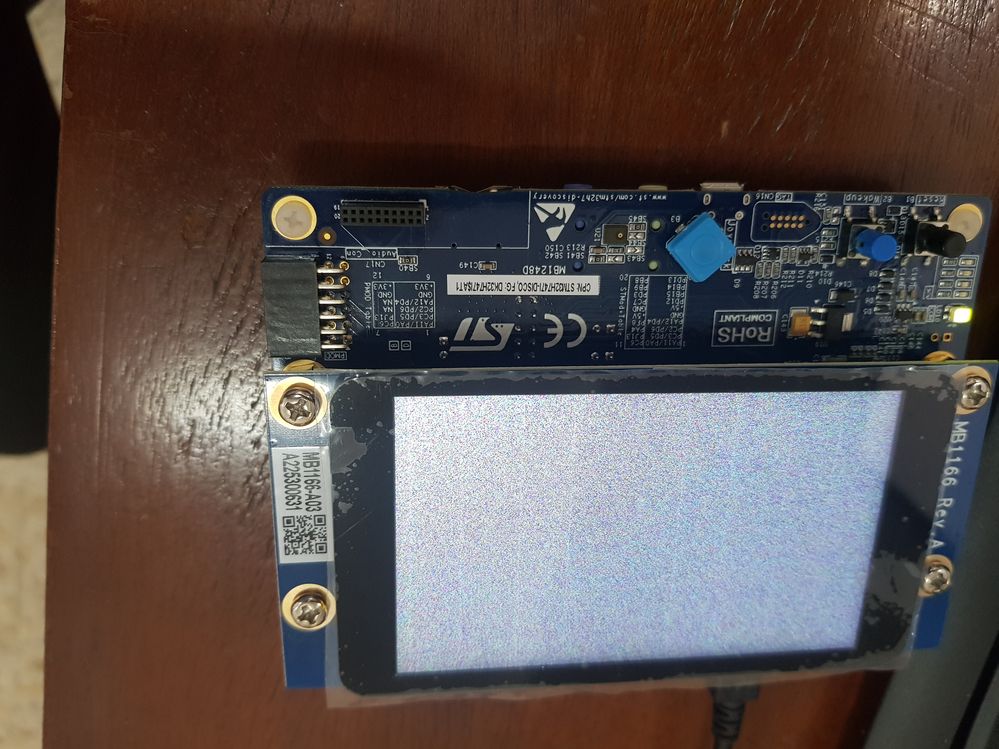

so all the lcd examples project have problems the display presents noise like the fellowing image :

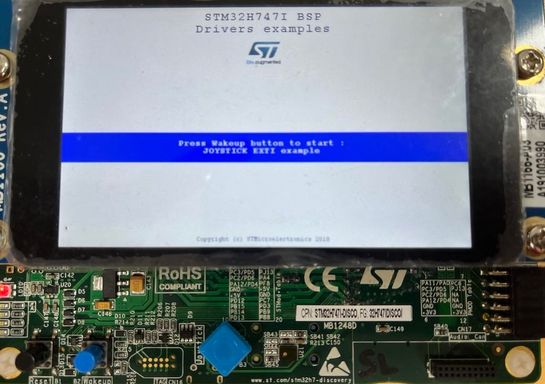

I've just run the example and it worked fine from my side:

I find the problem
the problem is the version of driver : the LCD FGRIDA FRD397B25009D-CTK replaced by FGRIDA FRD400B25025A-CTK
